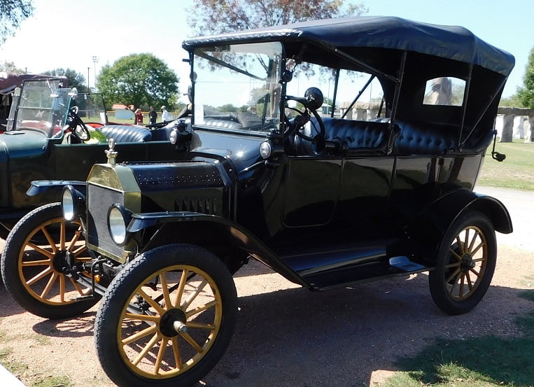

When the Model T was being sold and driven as a new car most Americans lived outside of cities on farms. There would seldom be any other car on the road. Meeting another car would be at a minimum an occasion to wave and honk. Perhaps you might even stop to exchange pleasantries, and to view the other driver’s machine.
Today most of us are faced with the challenge of operating our Model T on the same road as other modern cars with their not – so – attentive drivers. You and your Model T need to be on your game to stay safe out there.

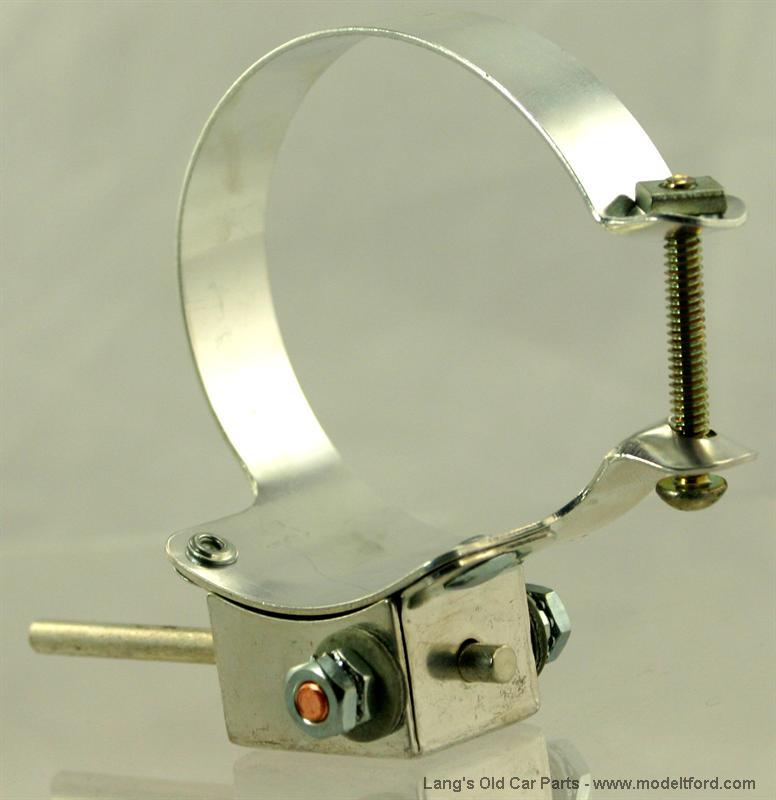

Above we see the stop lamp switch reproduction offered by Lang’s and many other Model T part sellers. There are several other ways to add a stop lamp switch to your Model T. Look at your options and get it done before you try to drive in traffic.

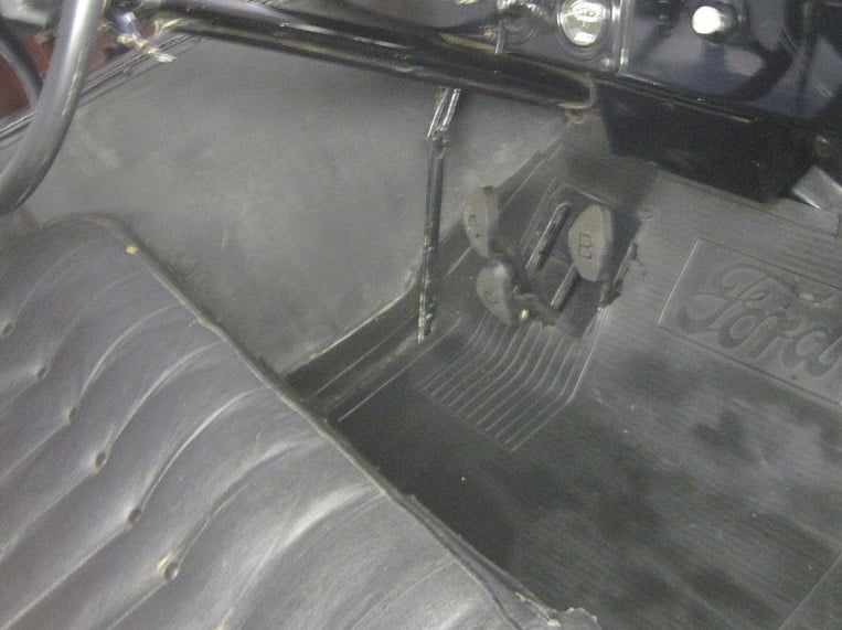

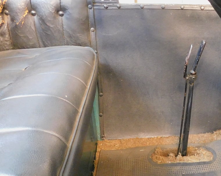

We will assume that you are starting off with the car idling, and the parking brake set. Place your right foot on the brake pedal and depress it. Squeeze the brake lever release and move the brake lever forward a few inches so it is positioned as seen above. That way the transmission can be used in Low and Reverse, and the car can be driven. You want to practice for a few minutes like this.
Above we see the spark lever pulled down 1/2 way which is a good position for most driving up to about 25 MPH. The throttle is pulled down a few notches so that the engine is at a medium idle speed. This is how the levers should look when you start from a dead stop on level ground. To start moving the brake pedal is released by the right foot at the same time as the clutch pedal (all the way on the left) is gradually but firmly depressed with the left foot.
You do not need to increase the engine speed to start moving. As a first time driver, you should practice starting from a dead stop and then becoming used to stopping the car from low speeds using the brake pedal. Keep the parking brake lever centered for now. Practice driving in reverse. Model T’s are notoriously unstable with regard to steering in reverse. Don’t go too fast or far in reverse, it can be an easy way to overturn the car if you were to suddenly turn while backing up. The steering tends to self center while driving forward in a Model T. When backing up the steering tends to flip right or left. Keep a firm grasp on the wheel.

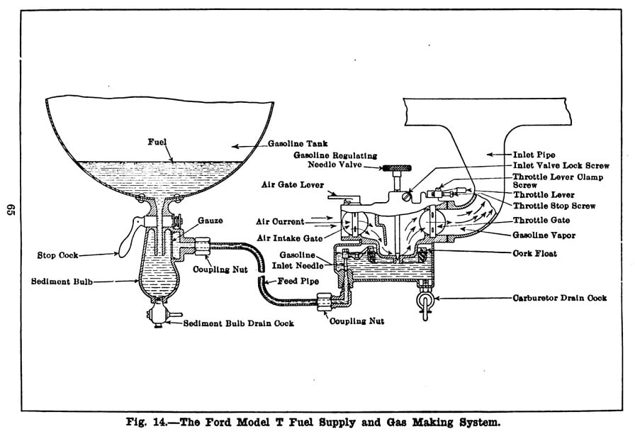

The fuel system in a Model T relies on gravity to supply fuel pressure. The illustration above shows a nearly empty tank on level ground. If the car is going up even a slight incline the carburetor is then above the fuel supply. The engine starves for fuel and dies. You won’t like that, so we recommend that before embarking on any trips that involve inclines that you fill the fuel tank to avoid problems.
