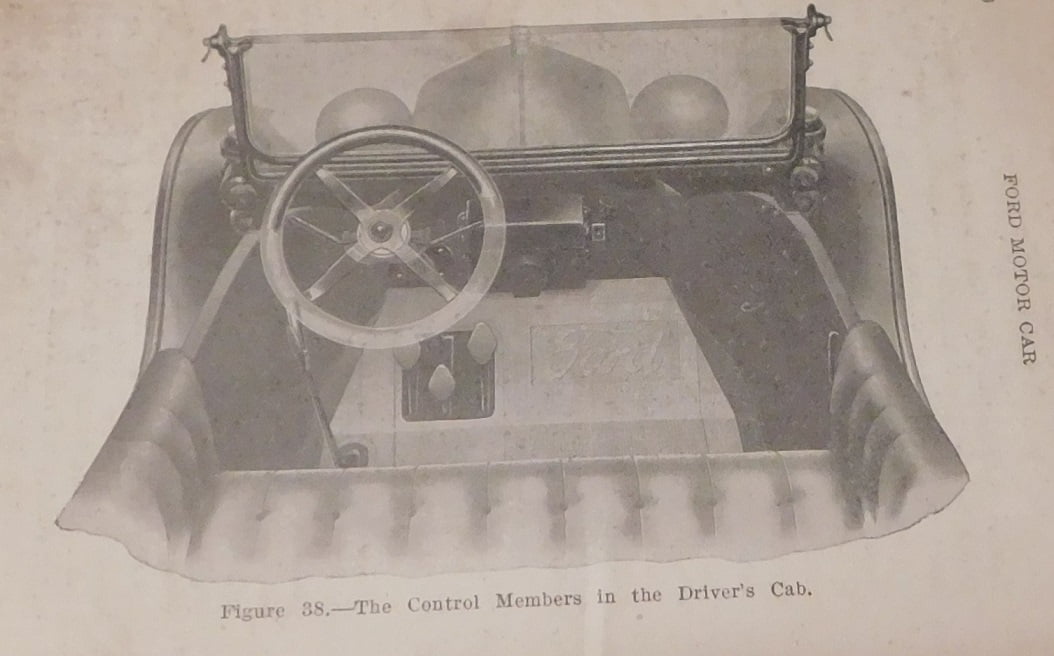

The Ford owners handbook for 1914 has a nice diagram showing the major controls and their names. We will examine each of the controls and their functions separately.

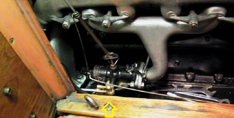

Above, many Model T owners have added an additional fuel shut off valve at the carburetor. This is a handy way to avoid getting underneath the car every time you park. Make sure this valve is ON (as shown) before attempting to start the Model T.

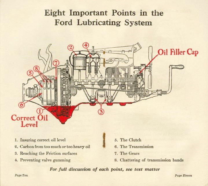

Oil level needs to be checked daily. In the image above, #1 is the upper oil level petcock. With the car parked on level ground, open this petcock. Oil should not come out. If it does it means the engine is over filled. Let the oil drain out until it stops. The bottom petcock is the lowest acceptable oil level for operating the car. If oil comes out the bottom petcock there is sufficient oil. Make sure both petcocks are closed before starting the engine.

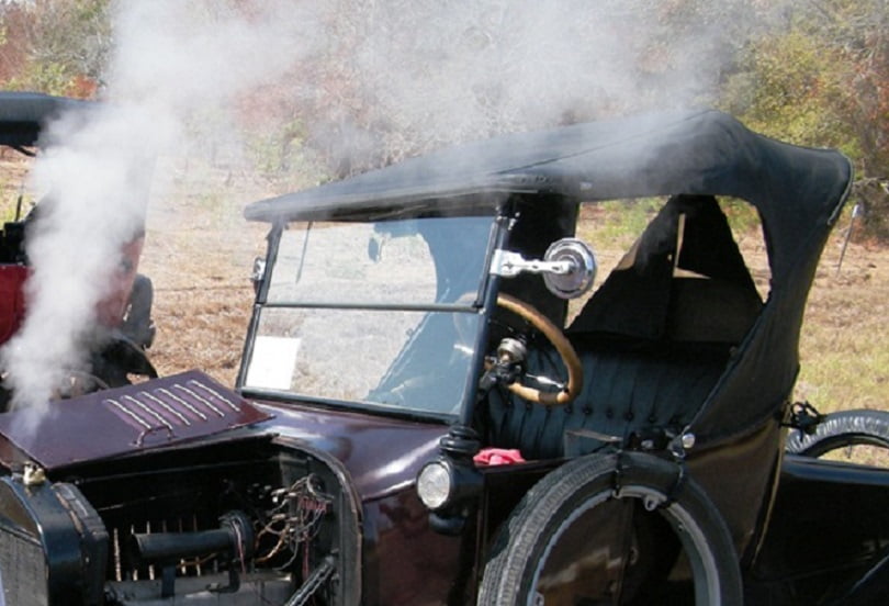

Always check the coolant level before the first drive of the day. The coolant should be above the fins in the radiator but lower than the word FORD on the radiator or radiator shell. Overfilling will result in water coming out the overflow when the engine gets warmed up. Not enough coolant will result in the photo above.

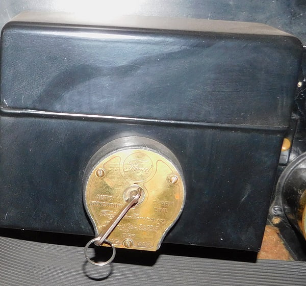

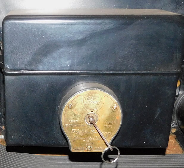

Above, 1913 – 1918 Model T’s and others with coil box mounted ignition switch are “OFF” with the key centered.

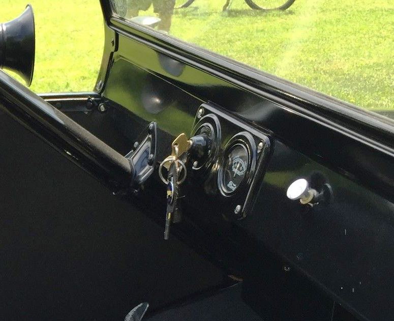

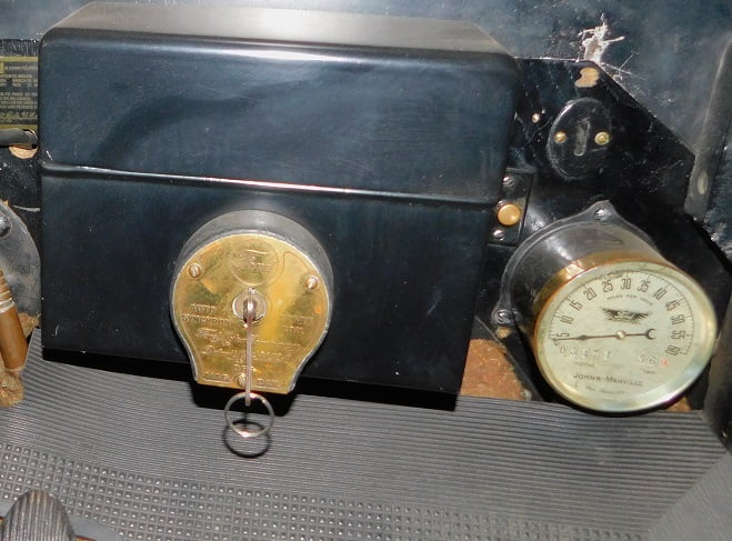

Above, 1919 – 1927 Model T’s with the ignition panel on the dash have a key that is off when centered. These cars also have a dash board mounted choke control to the right of the ammeter.

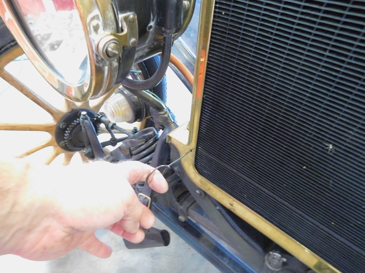

All Model T’s came equipped with a hand crank and a choke wire at the front of the radiator. The choke wire is pulled forward with the left hand until it reaches its limit of travel. Then with the key off the crank handle is pulled up from 9:00 to 1:00 with the right hand. If you have a starter equipped T this can be done from the drivers seat by pulling the choke and stepping momentarily on the starter button on the floor with the key off.
When the Model T is cold it will require some use of the choke before starting. Some cars like a little bit of choking, say one or two pulls on the crank with the key off. Other cars like lots of choking, perhaps four pulls of the crank with the key off. You may have to experiment to find out the correct amount for your Model T.
