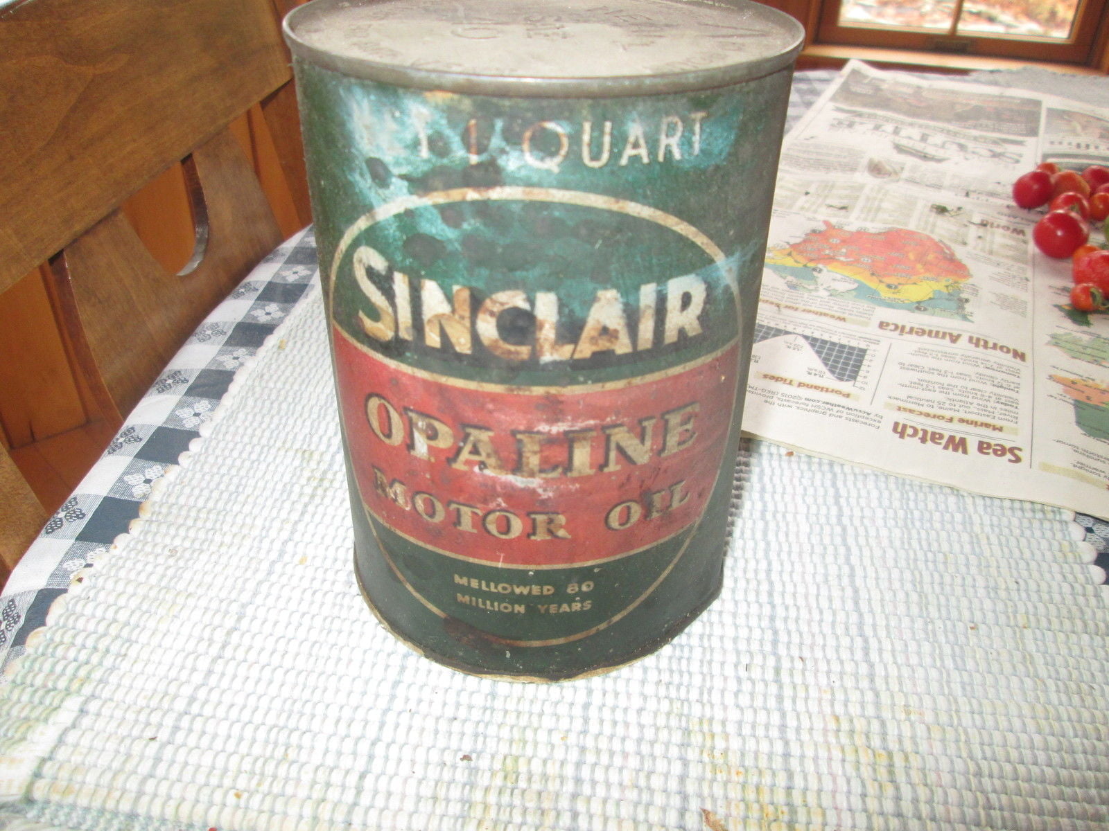

The guys who collect oil cans know the answer, because there was a period of time in the 1930’s – 1940’s when oil cans were marked with both the old “Light, Medium or Heavy” designations and the current designations. Here is an example of a “Heavy” motor oil from a Sinclair can of about 1940:
So we now know the answer. Here is a cross reference chart:
Light = SAE 20
Medium = SAE 30
Heavy = SAE 40
So we know definitively that Ford specified SAE 20 when your Model T was new. Back in those days there was no such thing as detergent oil, and multi – viscosity oil was also decades in the future. Let’s consider the advantages and disadvantages of each of these technology advances.

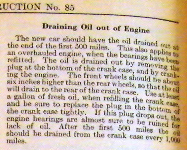

How often should the oil be changed in a Model T Ford? Again we look to the recommendations from back in the day. Here is what Dykes had to say:
So the answer should be to change oil every 1000 miles or every year, which ever comes first.
